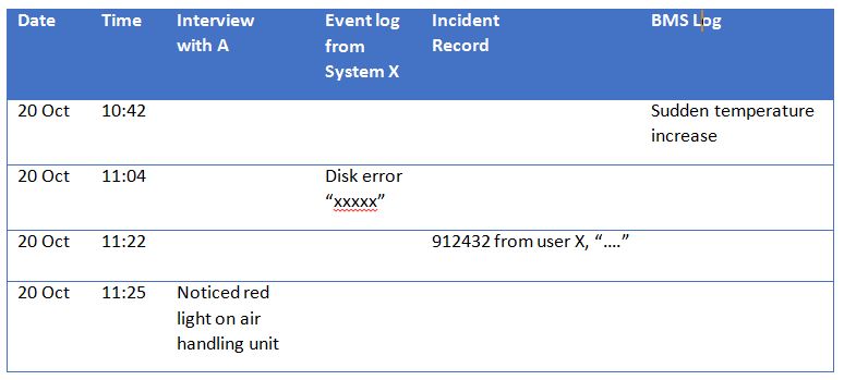

2. Timeline Analysis
This is such an easy way to investigate an incident or problem that it barely deserves a name. You simply list everything that happened in time order and then look for patterns. What is important is that you get all the data from multiple sources and then sort it by date and time, regardless of where it came from. Your timeline may have entries from system logs, emails, service desk records, and many other sources. This simple approach is surprisingly effective at building a complete picture of what’s been going on.
Figure 1- Example timeline analysis
I almost always start with timeline analysis, because it’s often enough to let me understand what happened, and it also ensures I have all the information I need if a more sophisticated approach turns out to be necessary.

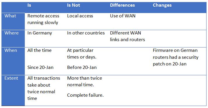

3. Kepner-Tregoe Problem Solving
Full disclosure: I have to declare an interest here as I used to teach this proprietary approach to problem solving. But I honestly do think that it’s incredibly effective.
It’s a structured approach to problem solving, where you define the problem across a number of different dimensions (what, where, when, extent) and you also bound the problem by identifying what is NOT failing. You can then review the distinctions between these to identify possible causes.
Figure 2- Simplified example use of Kepner-Tregoe problem solving

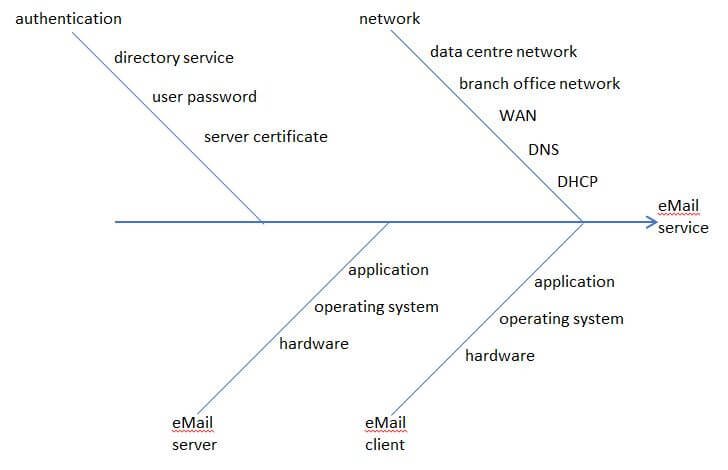

4. Ishikawa or Fishbone Diagrams
An Ishikawa diagram is a way to progressively break down potential causes of a problem. Causes are grouped into categories, to help understand and visualize the relationships. You can create such diagrams to help identify all the potential causes of an issue during diagnosis. But they can also be created as part of the product documentation so they’re already available to help with troubleshooting any issue that occurs.
Figure 3- Simplified example Ishikawa diagram for an email service
