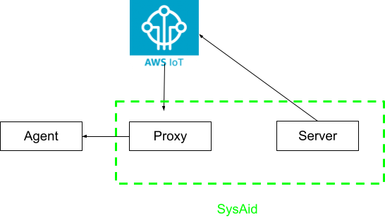

If only we could run IoT on our own servers, or at least redirect the traffic through our IPs. Well, as it turns out we can. IoT can use the MQTT protocol, but it can also run MQTT over HTTP websockets, which opens up the possibility of using an HTTP proxy. So now, instead of our server and client connecting to the IoT broker to pass messages, the client has to route the connection through a proxy, the proxy is in SysAid’s IP range and voila, problem solved.
'If only we could run IoT on our own servers, or at least redirect the traffic through our IPs.' Well... it turns out, we can. This blog explains how. #SysAid #Tech Share on X
AWS IoT logo above cloud; green dashed line centers on SysAid's ITSM integration, showcasing seamless service management. - SysAid

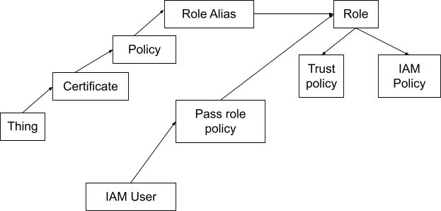

Security infrastructure (authentication and authorization)
A sleek black square symbolizes SysAid's seamless ITSM integration, enhancing Help Desk efficiency and connectivity. - SysAid
Yeah, that’s a lot to unpack. The security infrastructure (see diagram above) is composed of the following elements:
  1. Thing (the representation of our device on the AWS side)
  2. Certificate
  3. IoT security policy
  4. IoT role alias
  5. IAM role
  6. IAM policy
  7. IAM role trust policy
  8. IAM user
  9. Pass role policy
Here’s how it works: the Thing is connected to a certificate which is connected to an IoT policy. When our device authenticates to AWS using the certificate the IoT policy allows the Thing to assume an IoT role alias which points to an IAM role. The IAM role has a policy which allows a device to publish and subscribe to specific topics. Finally, you need an IAM user to pass the IAM role to IoT so the role alias can be created.
